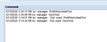

I played around for a bit and came up with an “Action Log”.
It is implemented as a customization at the form level. Use the Form Event Wizard to make a BeforeTool event, and set it like:
private void QuoteForm_BeforeToolClick(object sender, Ice.Lib.Framework.BeforeToolClickEventArgs args)
	Ice.Core.Session ss=(Ice.Core.Session)QuoteForm.Session;
	//MessageBox.Show(args.Tool.Key);
	string cs = args.Tool.Key;
	string userID = ss.UserID;
	DateTime localDate = DateTime.Now;
	EpiDataView edvQuoteHed = (EpiDataView)(oTrans.EpiDataViews["QuoteHed"]);
	if(edvQuoteHed.HasRow){
		string ActionLog = edvQuoteHed.dataView[edvQuoteHed.Row]["QuoteComment"].ToString();
		ActionLog = ActionLog + Environment.NewLine;
		ActionLog = ActionLog + localDate.ToString();
		ActionLog = ActionLog + " by: " + userID + ": ";
		ActionLog = ActionLog + " Tool used: " + cs ;
		edvQuoteHed.dataView[edvQuoteHed.Row]["QuoteComment"] = ActionLog;
(note there’s a bug in that. It doesn’t work right when no Quote is loaded.)
Edit: changed if() to check if edv HasRow. Should work fine now.
That writes it to the QuoteHed.QuoteComments, but you could add a UD Column to OrderHed, and add a sheet to display that UD field as a read only.
Here’s a sample:

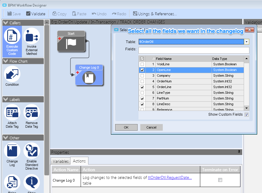

There are also different options for how the change log is captured. Under Company Configuration > Modules > All Modules > General. Change log collection methods are daily, by user, by transaction. You could play with those settings in a test environment and see if that helps any.
I’m not sure when this feature came out, but I know it’s in 10.1.
