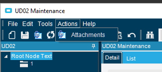

I was able to enable the Change Log on UD02, and I was able to verify that it is active by running the Change Log Report. Is there any way to add a button to access it from the entry screen, or through the Actions menu? Other entry screens have both, but on UD entry the only thing available under Actions is “Attachments”.
image image
Some screens don’t have the viewer. You can make a baq/dashboard to see the records though.
Good idea. 2 minutes to make a BAQ, just need to add a button to the entry screen to launch a dashboard and done.
Thanks.
Most of the time trackers have change logs. Entry screens do not. The BAQ is the right way to go.
Go one Haso. Forgot about that little note in E10. Need a data directive to enable it.
