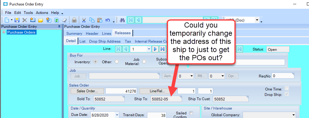

Are all of your sales order lines for Buy to Order? Are all open Sales Order Lines in system going to this new location? The shipTo ID is referential I believe. You could consider for the sake of time changing the address on the associated shipTo id to get out door to right place and then take time to clean it up properly. Not a most elegant fix, but a quick one.

Also, not sure if I explained suggested quick fix well enough. See screenshot.
Actually ended up changing the Customer address on the header and reprinted the POs. Weird thing is, it prints the new address as the Line/Release ShipTo, but does not change the address I see under Releases/Drop Ship Address. Curious now how you even set a one time address, must have to be done as a “on the fly” kind of thing and not as a temp change.
