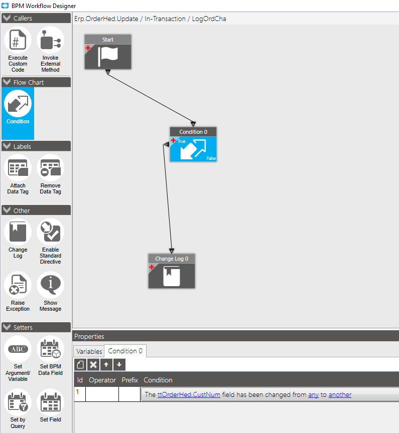

This is a different table, but the concept should be the same. Put a condition block in above the Change Log block, and use the field changes:
[cid:image001.png@01D2CA72.58D2FAF0]
If you do where PartNum has changed from any to another, that should give you what you need.

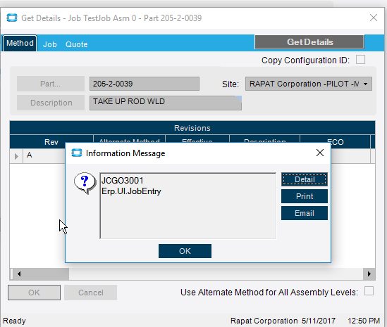

Have you looked at what is being passed to the BPM via callContextClient.ProcessID / callContextClient.AssemblyName for the various methods that trigger this BPM?
That might be a uniquifier for you.
It looks like those are the same for when I get details and change something manually. Bummer, I was hoping that would have done it.
