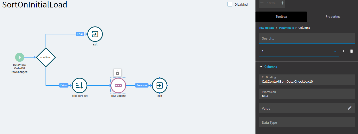

Hey I was thinking about this over the weekend and I think I have a solution for you, if you’re still looking:
You can get it to sort when it initially loads by firing on the DataView > Row Changed hook. That gets the sort done when the dashboard is opened, but it would fire every time a row is changed, which isn’t super helpful. To get around that, I put a condition in front of the sort:
"{CallContextBpmData.Checkbox10}" === "true"
When the form loads, the checkbox will be false, so it will sort by the column you specify. After the sort, I use the row update event to set the CallContextBpmData.Checkbox10 to true before I exit the event. That way, the sort event only fires the very first time row-changed occurs, right after the grid is initially populated.
