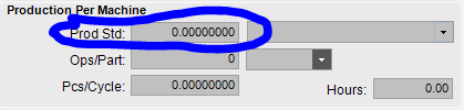

My questions is about, How and where i change the estimated production hours in Epicor.
Fx we use 100 est hours to produce A. Then we make some improvements and now it takes 80 hours. How and where do i make this change in epicor for Product A.

It is available in the Operation details in Job Entry.
This can also be set while defining the Method of manufacturing (Revision creation = Bill of Material and Bill of operations)
Okay, thank you.
Will i also have to make the changes in Part Entry - Part --> Operations --> Operation Times?
Yes you would have to use the engineering workbench to change the part method also.
