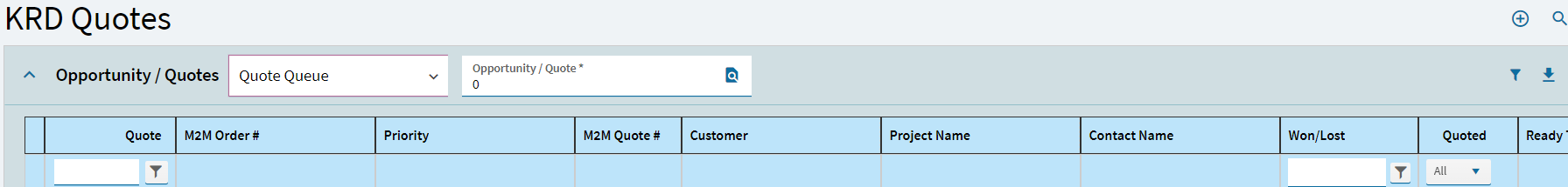

So, we can’t search for Priority, or Customer, or Project Name (see attached graphic) until we download them all. We did try to override these fields and force show the “blued-out” boxes under each column header, but this results with errors when entering anything into the now, forced, search boxes on the columns which should have been “blued-out.”

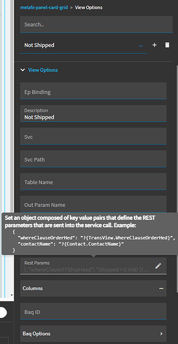

If you have a pre-defined set of filters, you can define those in View Options, as well!
We have thousands of Transfer Order Shipments, so the landing page grid took forever to load - so now we just have the UnShipped shipments appear on the default View.

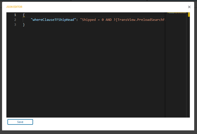

Using Rest Params:
and modifying the whereClause:
