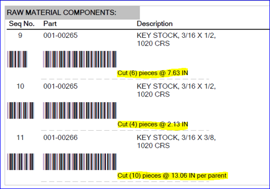

For our use case, we need so many Inches of bar stock to fulfill the job… BUT, we actually need that length cut into a certain number of pieces.
There is a “number of pieces” field, but I think that was tied to Advanced Unit of Measure functionality (if memory serves).
So we add a manufacturing comments to the method, instead.
This is how those comments appear on the traveler:
You could also add comments under a specific operation in ECOOpr.CommentText depending on where you want those instructions to appear on your traveler.
