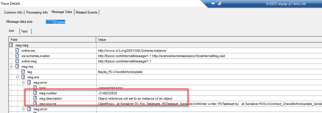

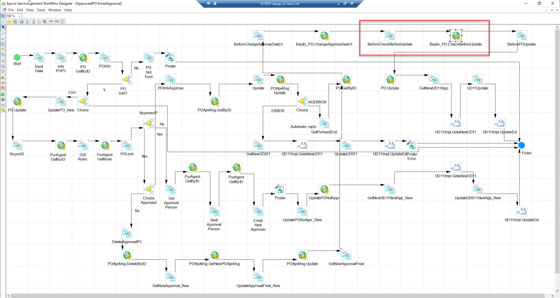

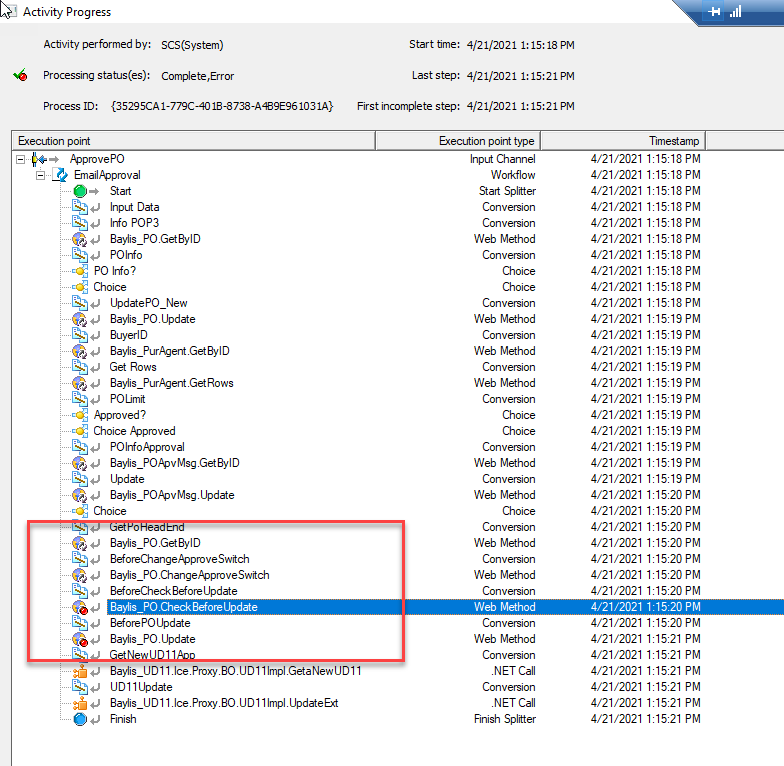

I have a Service Connect Workflow for PO Approval and when my workflow reach the CheckBeforeUpdate step, I receive the following error message: “Object reference not set to an instance of an object.”. I followed the Epicor trace and it’s look like everything is ok but…

Check all needed information is pass (as per Epicor tracing) to the request method or check if there any BPM(Method/Data) on this method.
Hi Dnyanraj_Patil,
there is no BPM/Data involved to this method. I compared the tracing log and everything seems to be passed correctly but I know I probably missed something but what, that’s the question lolll

Disable the BPM then try maybe it will give more ideas for troubleshooting.
