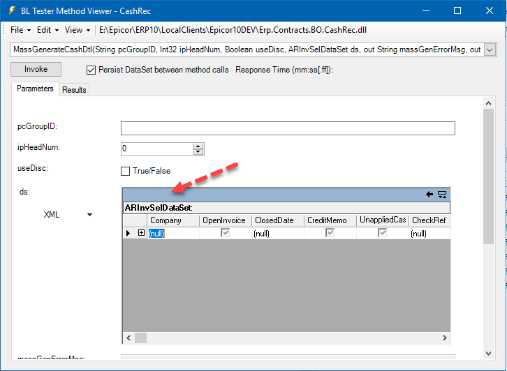

I am working on a tool to help upload cash receipts from a CSV. I’m running into hell with it on the MassGenerateCashDtl method.
It looks like it ingest a dataset of type ARInvSel.
When I set the fields in my code, it does not recognize a row at position 0. Should I be trying to create a new row in this table manually?

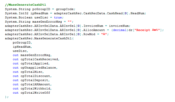

Example
DataRow dr = adapterCashRec.ARInvSelData.ARInvSel.NewRow();
dr["Company"] = "..";
dr["InvoiceNum"] = invoiceNum;
dr["RowMod"] = "A";
adapterCashRec.ARInvSelData.ARInvSel.Rows.Add(dr);

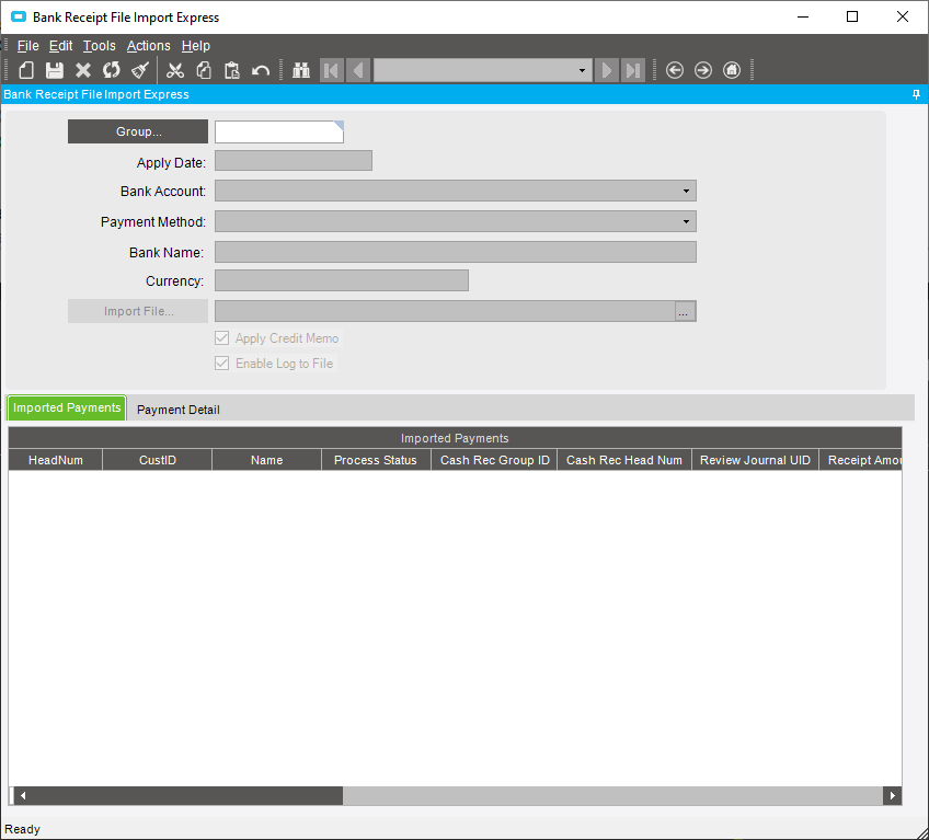

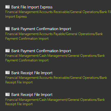

You might want to check out and see if this already does it…
That’s my fallback. The file from the bank isn’t formatted well so I was hoping to give the option for the user to use that file, my thing parses and consumes it
I am going with this stock method, I didn’t even know this existed. Work smart, not hard kids!
I had an impossible time trying to figure out what configuration was needed for Bank Receipt File Import and it looked like one needed to create a custom “Program” based on an existing one to define the conversion protocols. I’m sure that’s how it’s done, but since I didn’t have time to mess with it, I ended up just creating a program to do this.

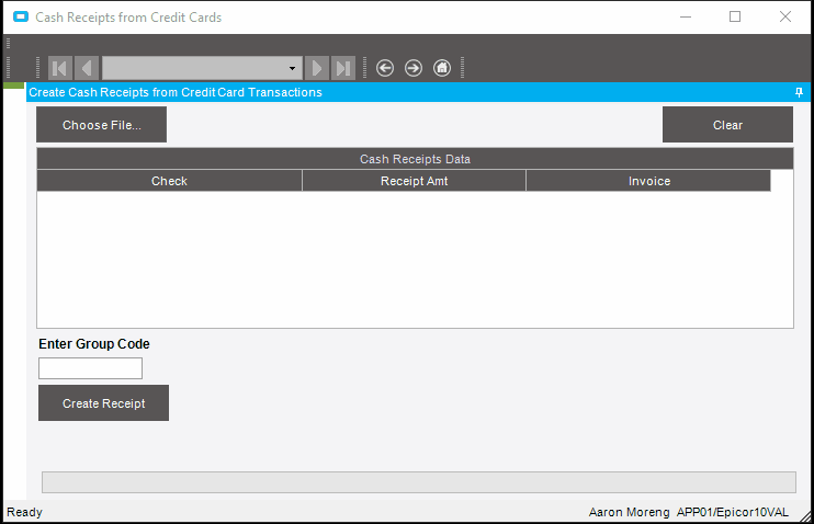

// Custom code for UD01Form
// Created: 6/1/2018 12:10:31 PM
using System;
using System.ComponentModel;
using System.Data;
using System.Diagnostics;

								System.String pcGroupID = groupCode;
								System.Int32 ipHeadNum = adapterCashRec.CashRecData.CashHead[0].HeadNum;
								System.Boolean useDisc = true;
								System.String massGenErrorMsg = "";
								var dataRow = dapterCashRec.ARInvSelData.ARInvSel.NewRow();
								dataRow["Company"] = "JRF";
								dataRow["InvoiceNum"] = Convert.ToInt32((string)dr["Invoice"]);
								dataRow["AllocAmount"] = (decimal)dr["Receipt Amt"];
								dataRow["RowMod"] = "A";
								adapterCashRec.ARInvSelData.ARInvSel.Rows.Add(dataRow);

This takes a file of known column positions from the bank and brings it into grid to review. Then it processes the queue and creates cash receipts.
For multi-invoice payments, it will play the payment “on-account” for the AR person to allocate manually, otherwise it will apply the full receipt amount to the invoice if the invoice number and amounts match.
Hi Aaron,
if you don’t mind, could you please share the file format.
Hey, I don’t think the file itself would be helpful, but all you need to do is align your column positions with the fields you want to consume
