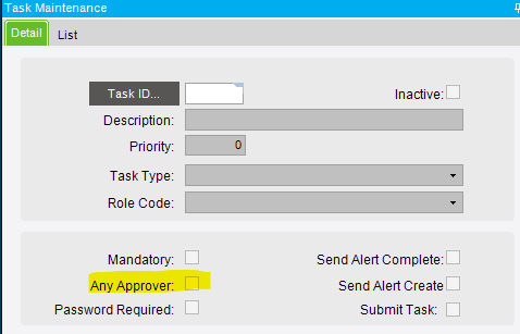

Hello Nolan,
Have you tried this?
Hi Mark,
Yes I have. That doesn’t seem to work.
