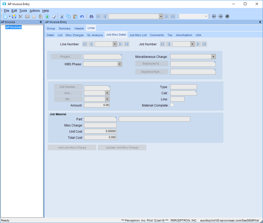

Hey Brad,
If you could paste a screen shot of your phase detail page, I can point out the WBS Phase Job.
In AP Invoice Entry, you would assign costs from AP on this screen:
You’re referencing the WBS Phase Job where there should be one per phase.
Mark W.
