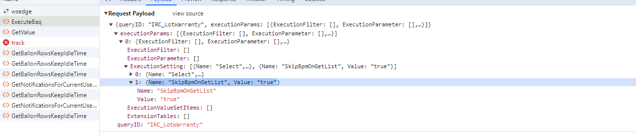

I did a trace on the Kinetic form using the Chrome Developer tools, it appears that’s executing the Ice.BO.KineticErp.ExecuteBaq method. I put a post-processing BPM on that - it’s displaying a message that it’s hitting it. However, when I tried using the same code, I’m getting a compile error. Says List does not contain a definition for ‘ExecutionParameter’, etc. I tried finding a Using or Assembly Reference, not sure if I’m finding the correct one though.
Tried removing the “SkipBpmOnGetList” parameter. That seemed to execute fine, but still didn’t allow the GetList bpm to trigger.
