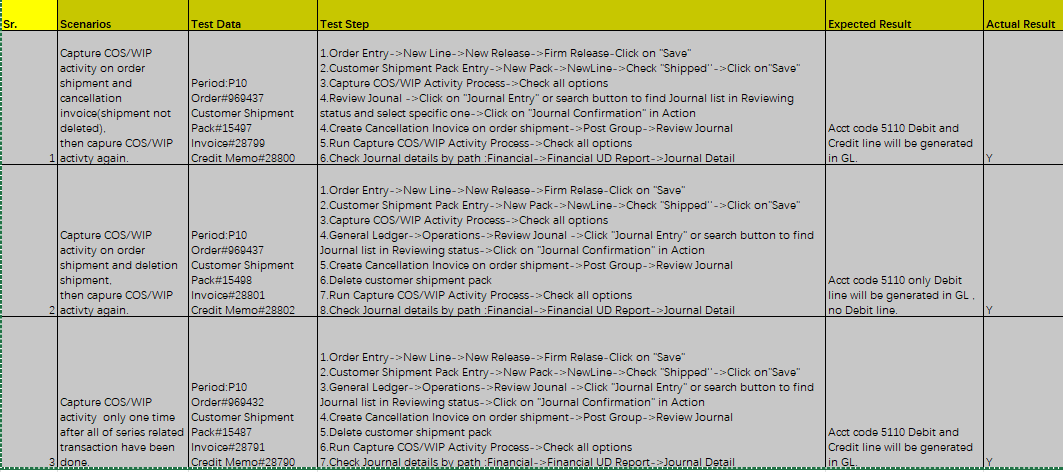

I have conducted test cases on Capture COS/WIP Activity and found deletion customer shipment result in COS CR line can’t be posted . What’s the reason?
@Jennifer.Wang Is the entry unbalanced which I assume not since you ran a finance report after. So the rules are doing something else. Do you have the GL Transaction hierarchies? They are a must have for finding the account this will hit.
