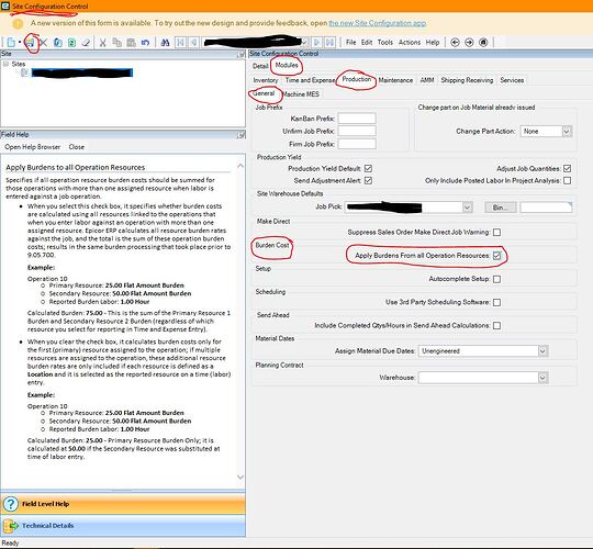

There is also a field under Site Configuration > Modules > Production > General, called Burden Cost. According to help it:
“When you select this check box, it specifies whether burden costs are calculated using all resources linked to the operations that when you enter labor against an operation with more than one assigned resource. Epicor ERP calculates all resource burden rates against the job, and the total is the sum of these operation burden costs.”

NateS … There is no Site Configuration > Modules > Production > General > called Burden Cost in the site Config. Could it be elsewhere?
DUH!!! I didn’t go to the Production Tab, pictures are so good for explaining things, :slight_smile:
