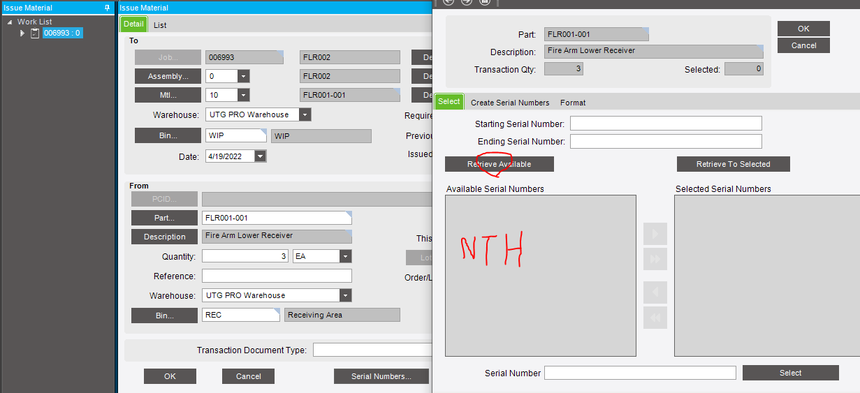

i am the first time to production the part with serial number. i am trying go through the processes. i made the main body with seairl number smoothly. Then i am stuck at the parent part assembly job. when i try issue Mtl to the job, i can’t retrieve available serialnumbers. i must make something wrong.
Could anyone point out?
following is the screen i am stuck.

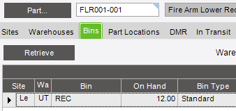

following is the part tracker of Mtl FLR001-001:

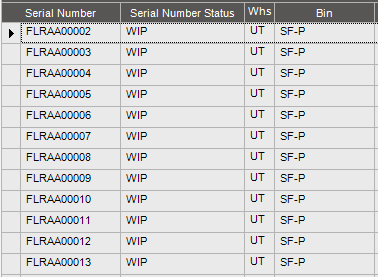

following are the serial numbers of FLR001-001

Short answer: type (or paste) the serial number you want into the white box at the bottom and click the Select button. You should get an error explaining the problem.
Long answer: You need to pick the right bin - and “right” is a loaded term. Yes you picked REC and there are 12 in REC, but the catch is that the PARTS might be in one location and the SERIAL NUMBERS might be in another location.
If that list is all of them,
A. They are in the SF-P bin (and not REC), and
B. The bigger problem, the status is WIP and not INVENTORY
Again, IF this is everything, something got out of whack and you may have to use Serial Number [Maintenance] to correct them to be in the bin that the qty is in (REC) and make the status INVENTORY.

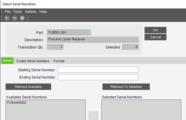

Hi Jason,
it works after i changed the serial number status and Bin location like what you said.
