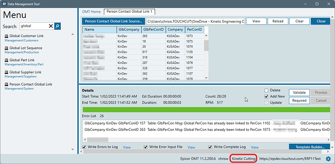

I got it to work.
I split the person contact links import csv in two; one for linking KNZ global contacts into KUSA, and one for vice versa.
Then when I ran the DMT I also set the target company in the DMT itself (double click on the company below to choose which), not sure if this is necessary or not, or which of my two changes made it work. But, success. I had assumed it was company agnostic and that that was what the company column in the csv was for.
(In the below I had manually linked 26 records already, but 2 new ones were successfully linked, 28 records processed)
I’m still not clear on exactly what setting the company in DMT UI does. Filter out company records not related to the current company from any csv imports perhaps?
