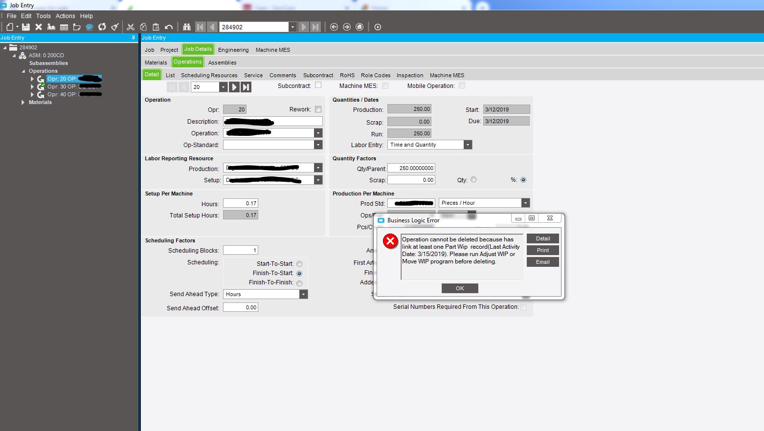

When I try to delete an operation in a Job, i get the following error. Note: There is no labor attached to this operation.
Operation cannot be deleted because has link at least one Part Wip record(Last Activity Date: 3/13/2019). Please run Adjust WIP or Move WIP program before deleting.
Error Detail
Description: Operation cannot be deleted because has link at least one Part Wip record(Last Activity Date: 3/13/2019). Please run Adjust WIP or Move WIP program before deleting.
Program: Erp.Services.BO.JobEntry.dll
Method: JobOperBeforeDelete
Line Number: 33226
Column Number: 17
Table: JobOper

Your Issue is
Doesn’t have to be Labor, could be some other Link.
You have to do a move wip transaction to get the part off of that operation.
So, I have looked at Adjust WIP and saw nothing. On Move WIP it showed a quantity for the previous Operation. My engineer was in here with me and she said that it could be that because the previous operation is 1 then that would force the next operation to be at lest 1, correct? Thus having a WIP???
Yes, WIP automatically get’s pushed to the next op once the operation is complete. If you look at that part number in part tracker you can see the location in WIP.
Use the Move WIP program to move it to another operation. Then delete the one that you want to get rid of. Epicor sent me this KB for the same issue.

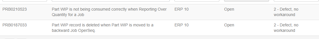

It won’t let you move wip. The system errors out and tells you it’s not there, even though if you do a query, it shows up there.
May be related to PRB0191122
https://epicorcs.service-now.com/epiccare?id=epic_prbform&amp;sys_id=62da9cd0db7f07406b16fa38bf961929&amp;table=problem
