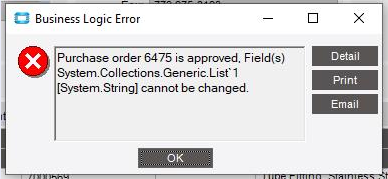

Can't change UD field on Approved PO
We weren’t overly happy with the functionality of the Promise Date so we added a UD field OrigPromDate_c to the POHeader table. When the PO is confirmed, we want to set the “Promise Date” using our new UD field. However, if I attempt to make the change after the PO is approved and then confirmed, I get this error:
If I disconnect this in my BPM, it works fine:

I can understand keeping Epicor fields from changing after the PO has been approved, but why will it allow me to change Epicor fields but not UD fields that have been added. Any ideas or thoughts?
@TDray If it is bound to POHeader then they all get treated the same. You will find plenty of threads here about having to unapprove, change and reapprove UD fields on POHeader. This is why I always search before I post as a lot of things already have solutions.
The approve step basically locks the PO except for a few fields such as the confirmed field. you simply need to unapprove, change the values, and then reapprove. Note that as long as you dont exceed the previously approved value, it will not need to go back to any upper approvers.

What I ended up doing was using the Epicor Promise Date on the header and a UD field on the PORel table.
When the PO is confirmed, I set the promise dates to the due dates and don’t allow them to change after that. Had to use the Epicor built in for the Header and the UD on the PORel. Any other combination didn’t work as I intended them to. Thanks again for the response.
