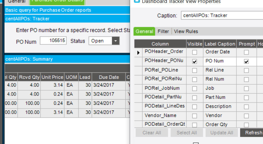

I have a dashboard which is working as intended but when I go back at a later date to add an input prompt, I can’t change any of the properties. I can’t make any changes to the check boxes, even the ones I have previously checked.
Then you will have to add it manually by customizing it further. Your screenshot cut off the far right side that has an EpiShape saying “Customized” I bet.
