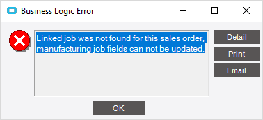

Now I want to Create a Shipment for the Sales Order Release, so I go to create a Customer Shipment Entry. I want to pull the stock “From Inventory” instead of “From Manufacturing”, I get an error.
So I add the job number in and put Qty to 0.
I will get the following error
What is the proper procedure on receipt to Inventory? Do I have to change the sales order?

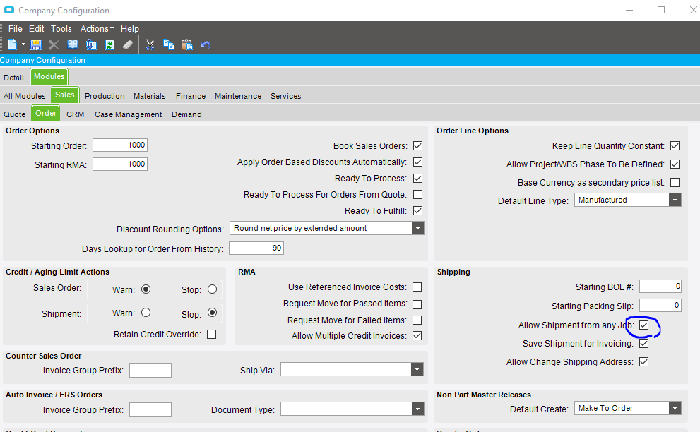

In the Sales Order Release, did the flag Make Direct ticked? I have the flag ticked and the job is created from the Sales Order. So when I am shipping, it expect the shipment from Manufacturing rather than inventory. I will do more investigation on how we should use the Customer Shipment entry.
Turned out it is a Company Configuration setting:
If you want to ship from any job or inventory, you will need to have the setting
“Allow Shipment from any Job” to be ticked.
