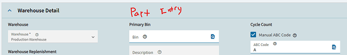

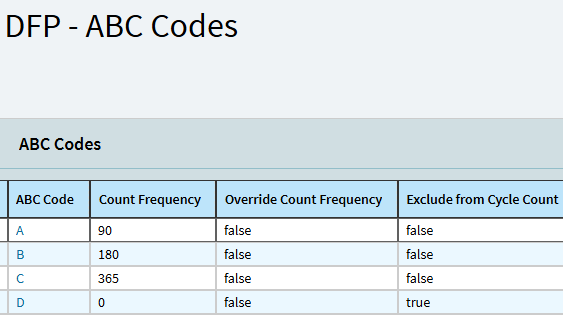

Both warehouse records exist for all active parts in PartWhse table and an ABC code has been applied to each one. We will be manually maintaining our ABC codes, so I have not bothered to enter anything regarding value in the ABC setup for each warehouse. I’ve made sure that there are no open cycle counts, that all of the parts have a last cycle count date outside of the expected count period, and that there is a quantity on hand for the parts.

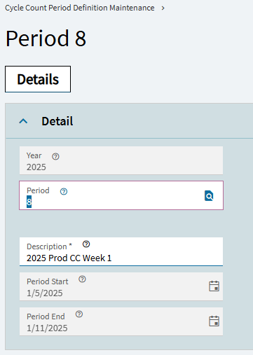

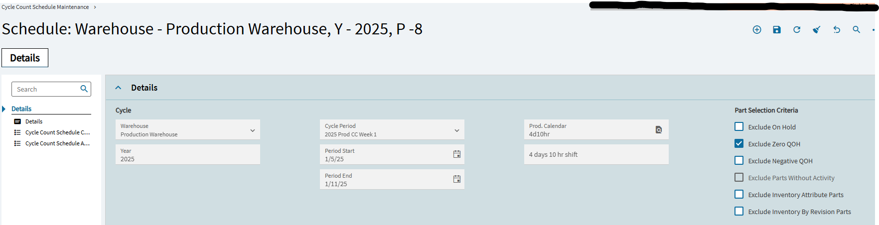

For example, the first period I am trying to schedule in the new Production warehouse is for 1/5/2025-1/11/2025 with a production calendar that is setup for Mon-Thu. There are only 10 A parts in this warehouse that all have a Last CC date of 12/10/2024 or 12/13/2024 and a count frequency set to 5 with Exclude Zero QOH checked by default. Would expect to see all 10 parts be selected for the period with 2-3 in each of the 4 count days.
I even went ahead and created the 2025 fiscal year and monthly periods, made sure the January period is open and transferred balances from 2024 to 2025. So far, nothing that I have done selects any parts. Am I missing something or is there a known bug around this in 2024.1.9??

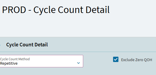

Expand for screenshots of my settings for reference:

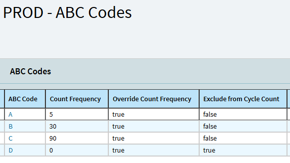

Is there a reason you are overriding count frequency in your PROD warehouse?

Honestly, checked that to see if had any impact, because it hadn’t previously been checked and the warehouse level is where we want all of this driven from, so I checked it to see if it would resolve my issue. It did not. Though the Prod warehouse is what I’m showing in my example, I am also not getting any parts to select in my stocking warehouse.

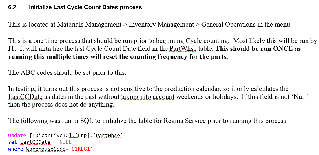

Thanks Jason. Normally clearing this date is the “nuclear option” because it will force all parts to be counted. I checked my notes from 2019 and with each Branch (site) I started the process with, I set the date to Null and then ran the initialize process to properly set the date. If there is any value in there - which part entry seemed to add on its own - then the initialize will not work.
There is no harm in putting in a ticket if there is the slightest trepidation here.
This is from my documentation from 2019. Epicor may have fixed this in the mean time.
I verified my work on 10.2.300 and ran the SQL update on my test server before moving this to live.

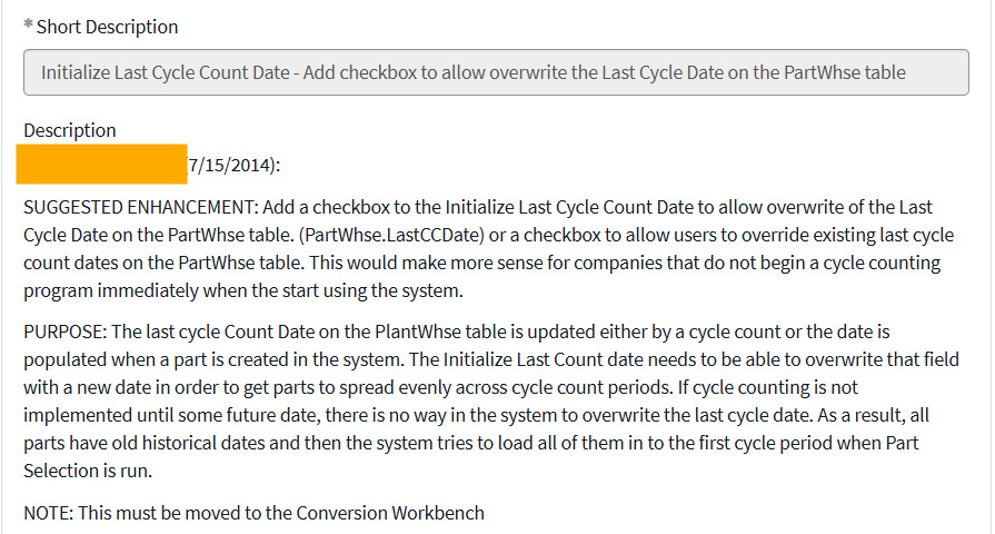

This is a good time to ask for votes on this!
Ability to clear out LastCCDate in PartWhse (for resetting a cycle count program)
Wow, if you count the enhancement request (PRB0086388) before the Ideas platform, this idea is now eight years old (Dec 2016).
Next year!
[Edit: No, wait - I was right the first time: it’s been a decade. PRB says 2016, but the notes say 2014.]
Just got off with Support on this issue and got it to work by updating the calendar that I had on my schedule. It is a 4 day calendar with Friday as a non work day. We added Friday back onto the calendar and then it did perform the part selection process.
So, I guess you can’t use less than a 5 work-day calendar on a cycle count? …I’m going to have to play around with that some more to see if I find a way to make it work on a 4-day calendar so that my cycle count guy doesn’t have to move selected parts from the last weekly sequence into the other four sequences every week.
