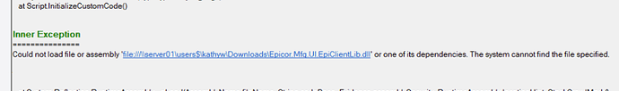

I have one user that randomly gets an exception error when opening a new form in the classic UX. The problem is not specific to a single form and is intermittent as well.
The common thread is that their is an inner exception error that indicates that the application is looking for Epicor.Mfg.UI.EpiClientLib.dll in the user’s Downloads folder.

Have you tried clearing the client cache / reinstalling the smart client?
Haven’t reinstalled the smart client, but have repeatedly cleared client cache.
if you have another environment, try copying it from there, a similar error happened to us a few months ago and that solved it
I’ve seen similar issues. There is nothing you need to do, other than report it.
Exit Epicor and get back in.
I got a little betting money saying somebody exported something to that folder like a baq to that folder recently.
