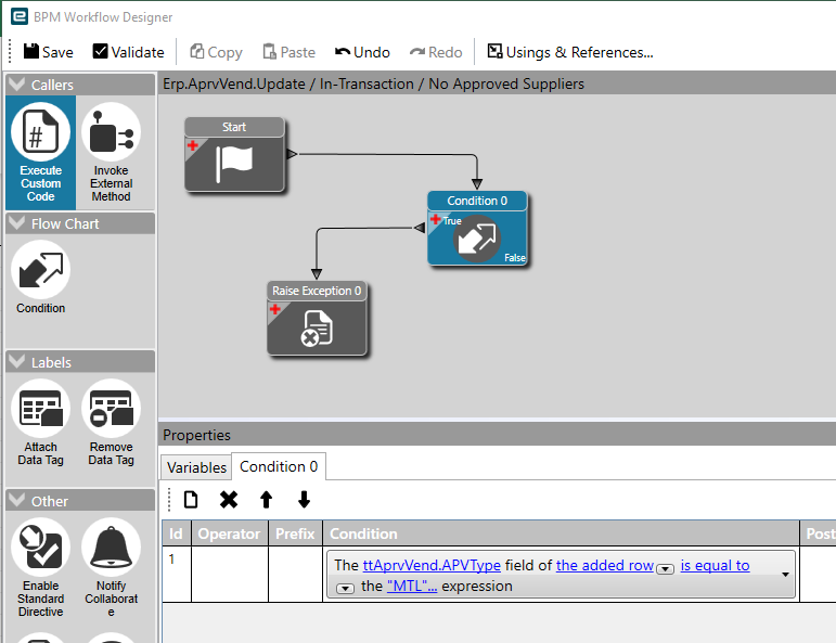

I made a BPM to stop people from ever adding a row to AprvVend. Problem solved. ![]()

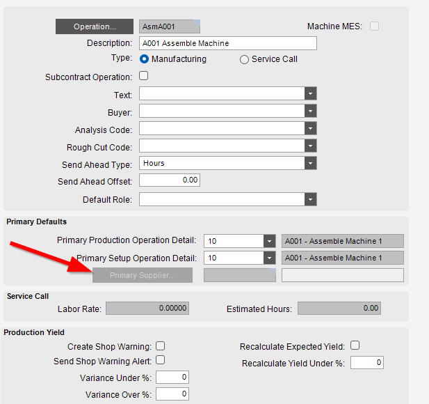

I think I ran into this before, If I remember correctly the Operation Entry screen has a field for Primary Supplier. If there is a supplier entered this causes trouble also. You will have to test to verify.
