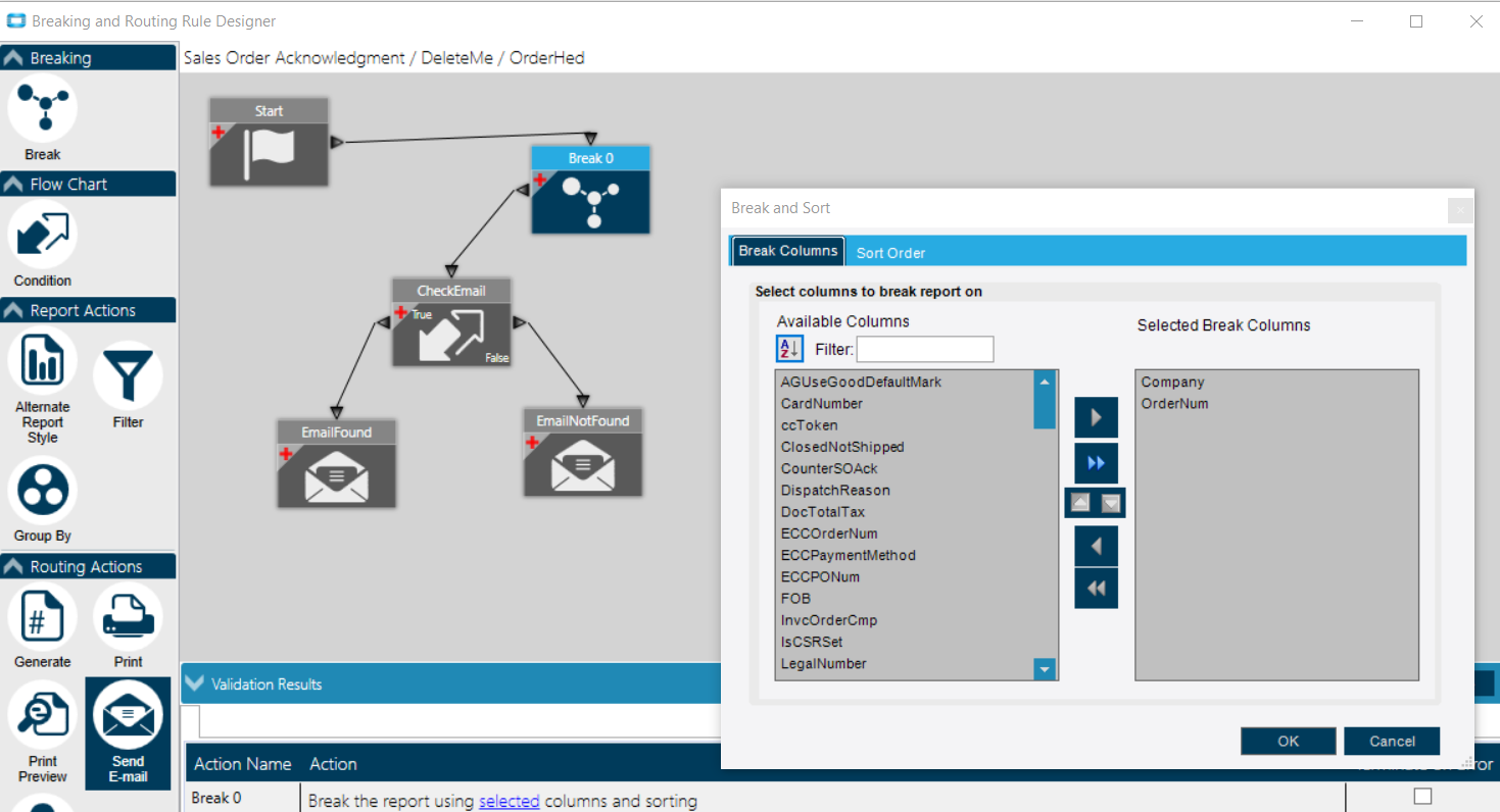

Will you screenshot your routing setup? Like the view of the widgets?

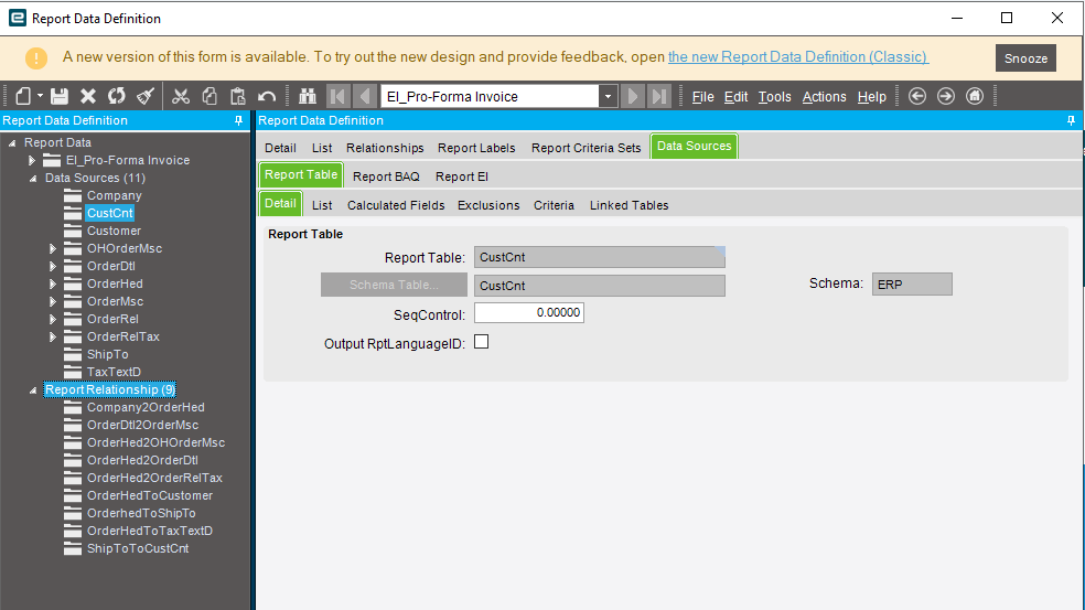

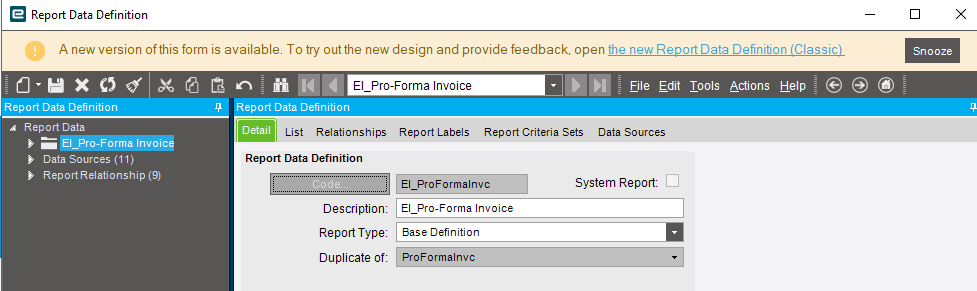

However here are the screen shots of the RDD

Mr. Simon: It looks to me like you may be missing a Break Node (or it may not be configured correctly)
Thank you so much. Your are quite right I was missing a break Node.
