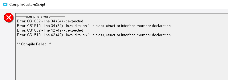

Ok. This is the first time trying this. I added an epiViewNotification event and I was getting strange errors with the code the wizard inserted. Looks strange because the view names have a /0 suffixed to them and in the code editor the / is green like it is a comment.
I am working with Jeff and this error is what pops up in customization mode even before we add any code:
Please note all these lines are empty in the Script Editor.

Ok so if we cannot Create a Customization in a RunTimeConfiguration form how can I clear this compile error so I can try Server Side UD method approach?
--------compile errors------------
Error: CS1002 - line 33 (33) - ; expected
Error: CS1519 - line 33 (33) - Invalid token ‘;’ in class, struct, or interface member declaration
Error: CS1002 - line 41 (41) - ; expected
Error: CS1519 - line 41 (41) - Invalid token ‘;’ in class, struct, or interface member declaration
** Compile Failed. **
Here is another example with the All Code selected generating the following compile errors:
Compiling Custom Code. The culprits "_PoleQCFITPage10/0_Row; " and “_PoleQCFITPage1FieldProperties0/0_Row”
----------errors and warnings------------
Error: CS1002 - line 37 (37) - ; expected
Error: CS1519 - line 37 (37) - Invalid token ‘;’ in class, struct, or interface member declaration
Error: CS1002 - line 45 (45) - ; expected
Error: CS1519 - line 45 (45) - Invalid token ‘;’ in class, struct, or interface member declaration

Hi Mike,
You just can’t run configurations in developer mode or with any customization specified as the default. Use the configurator designer(UI) to add the input.
