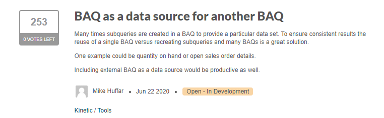

It’s in the Aha ideas portal (https://epicor-manufacturing.ideas.aha.io/ideas/ERP-I-158). It’s showing that it’s in development.
This is a feature a lot of people have wanted for a while.
Hopefully soon!
That’s really disappointing - you should just be able to reference a BAQ in another BAQ just like any other table - not as you said, referencing the subquery of another BAQ. Why is the idea marked in development if its not being developed?

Microsoft has solved it since the 90s (Access, SQL) so it feels like a gap that Epicor can’t do it. That aside, what is disappointing to me is that the idea is marked in development when its not. I took my votes away from this idea because I thought Epicor was already doing it. Although Olga deleted her comments for some reason, it sounds like it should be more accurately marked unlikely to implement, not in development. It really undermines confidence in the ideas site.
I believe it is under development.
The feature we just got is copy subquery.
The other one is still WIP
Ok Olga’s previous comment is that it wasn’t under development, maybe I misunderstood.
