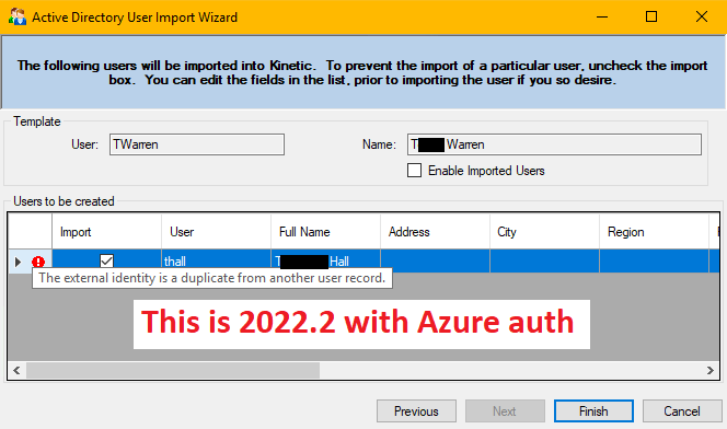

I am trying to create a new user with the wizard in the Admin Console. The catch is that I am using Azure (Entra ID) authentication. This is the first time I have ever tried this combination. Also, this is in a dev environment on 2022.2.
I am getting an error that “The external identity is a duplicate from another user record.
It’s definitely not a duplicate user. I am trying to add a user that’s not even a user in Production.
I also went to the trouble of populating EVERY existing user with an external identity, in case “blank” was the problem.

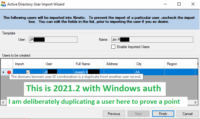

To be clear, I use this wizard all the time, with Windows auth, on 2021.2. If I really did have a duplicate there, it’s a different message.

I even get the error in dev with basic auth. It’s like it knows that I have dev setup for Azure.
