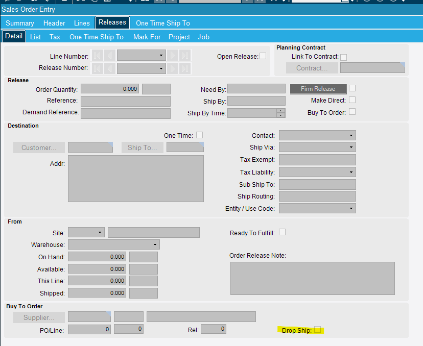

Drop ship is intended to bill a customer for product that was shipped to the customer from somewhere other than your company.
In our case, we use it to bill a customer for resin that we buy for them to make their parts and have drop shipped to us. The customer is billed for the resin when we receive in the Drop Shipment. As for the parts we make with that resin, the customer only pays for labor and burden for the parts that were manufactured then shipped to them. Kind of like time separate from materials (two invoices).
So I believe there has to be a Sales Order associated with the PO to create a drop shipment. There is a checkbox on the Sales Order release for Drop Ship. It’s where you link the PO to the Sales Order:

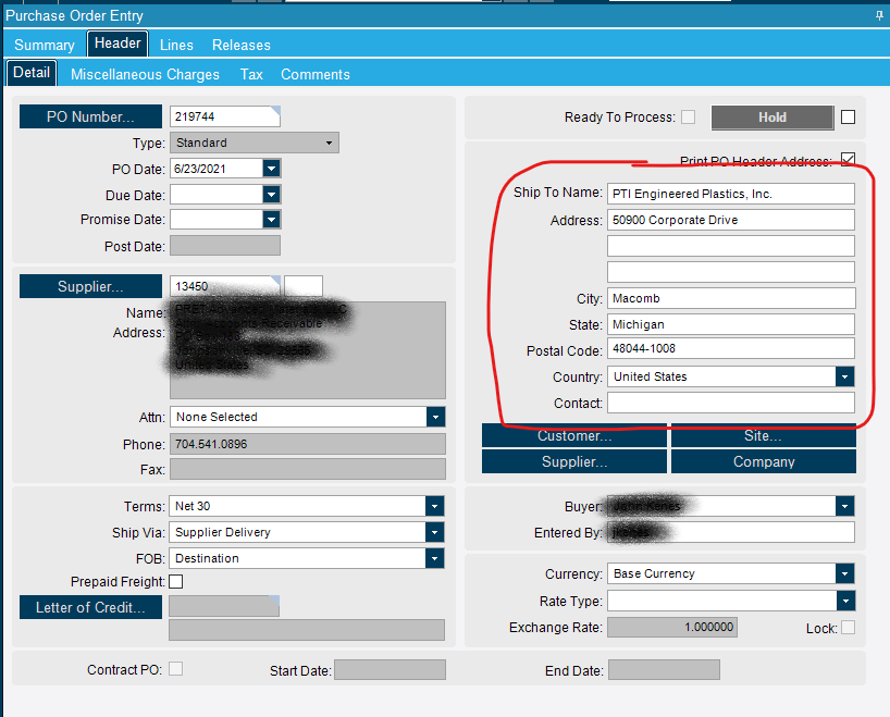

I think you can change the Shipping To address on the header:
Have you tried that?
I think the problem with that is the have a PO that says ship material offsite. So if you receive that material it’ll go into the inventory in the company but you’ll then have to ship.
Can you change the PO Line type to other? the receipt will need to happen however no inventory will be recorded.
