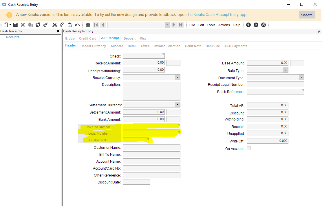

I see you can enter the invoice number under the A/R Receipt tab while entering the cash receipt:
This looks like it will accomplish what is needed as far as charging the card and also linking the charge to the invoice that was created from the shipment.

Yes, entering the Invoice Number is really the key to get the credit card linked to the customer and the invoice. I missed that in my cut and paste from our internal document.
