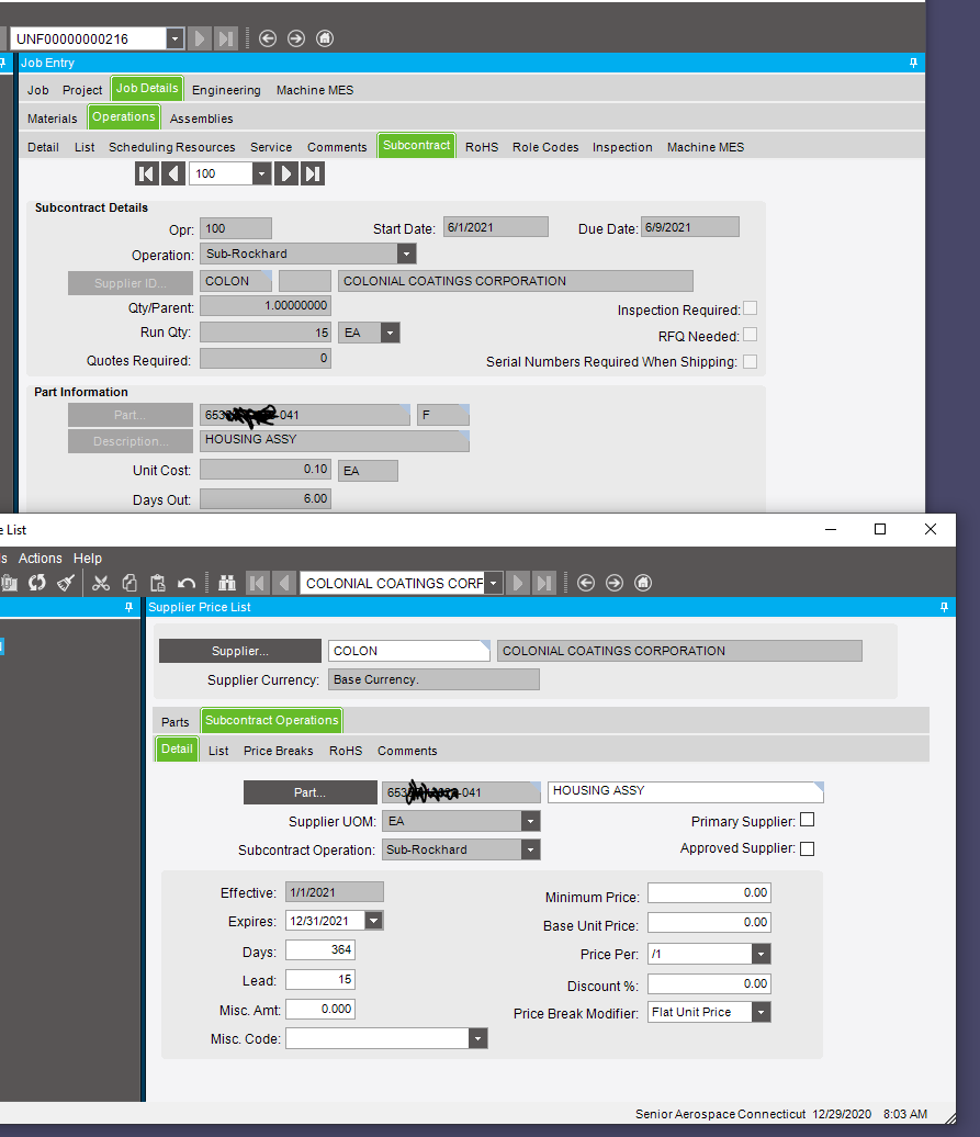

Here is a screenshot, I have had to mask the part number on this due to our information security guidelines. The part numbers do match. Top of view is the MRP created job, bottom of view is the Supplier Price List entry that I want to have applied to MRP-created jobs.
Do you have price breaks on that record in the price list?
No. We created these entries yesterday.
It’s been a while since I worked with the SPL and I remember there being some bugs on how it actually works vs. how it is supposed to work.
Is the lead time on the part site record 6 days?
Part site record doesn’t mean anything to me. Normally what we see is the lead time and pricing on unfirm jobs comes from the method, unless there is a corresponding supplier price list entry for the part number, operation description and supplier in the date range. Then, the supplier price list entries are what populates the unfirm job.
So, is the 6 days lead time on the method? Also, is the $0.10 on the method?
I noticed there is no price on the SPL. That might be what is causing the issue.

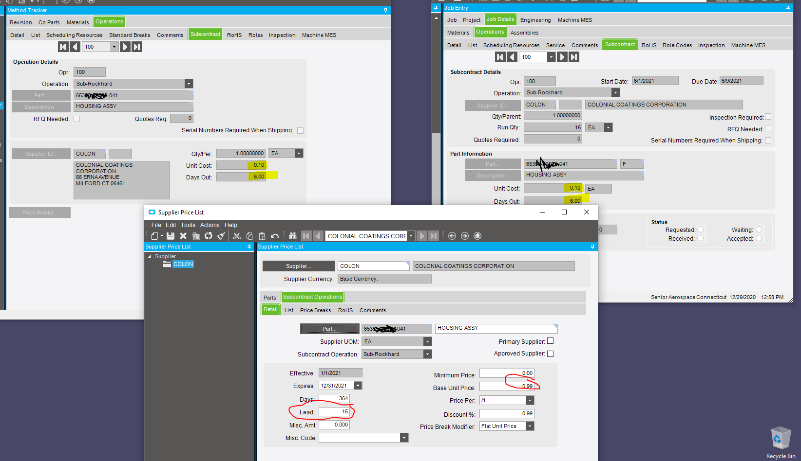

Screen below shows - MRP newly created job (on right), method master (on left), supplier price list entry (on bottom).
Clearly the system is not getting the data from supplier price list.
Screenshot shows Effective date in the future.
The operation date is scheduled for that time frame, but I can modify that as well.
Are you certain this is the cause?
