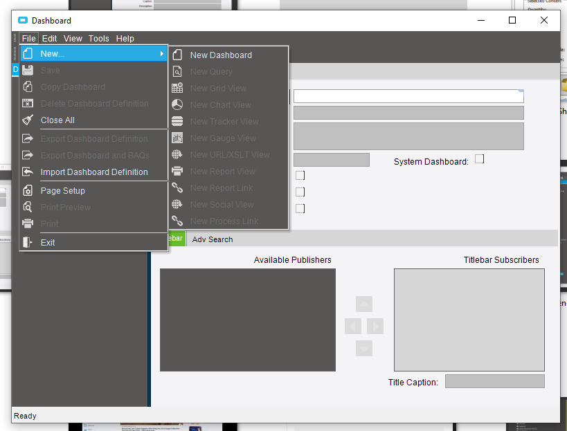

Can not open Dashboard to edit in Dashboard Program
I have a custom dashboard that I can no longer edit. When I try to open it Dashboard module, using the Definition ID search function, the Dashboard screen comes back blank.
It does the same thing if I am in Dashboard Maintenance, and select Action>Modify Dashboard.
Every other dashboard opens fine for editing. Any suggestions on how I can fix this?

Is there a diff way I can export the dashboard, since I can not use the Export function from the Dashboard module?
The export functions are grayed out.
If you cannot access the dashboard through those forms, then you should try the customization maintenance. If you can get the customization to load in that form, try using some of the tools there. You have import/export, verify, delete and more. If you can get your broken customization out of there, you might be able to get back to your base dashboard. That way you can start a fresh customization. You may just need to recreate the dashboard completely.
