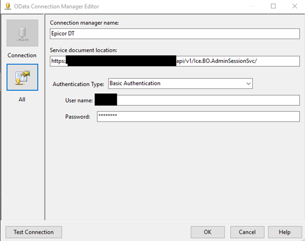

I ended up using SQL SSIS package using an OData connection to grab the data from Ice.BO.AdminSessionSVC. If anyone is interested, I could put together a quick overview of how to do this. It turns out it’s pretty easy once you know what you are doing
Sure, where do you want me to start from I will see how much I can screenshot without giving away too many details. This will assume that you are MT, DT, or possibly Single Tenant, I only know for sure that MT and DT have the web services enabled.
OK here is a bit of a summary. I haven’t gone into complete detail, just showing you the bits that are common to any attempt at this. You’ll want to work with your development staff and IT team to figure out security, etc. etc. your mileage may vary Here is one way to do this.
In Epicor, create a username with the permissions required to access this information.
Create an OData Connection Manger in an SSIS project to connect. Use the account from step 1 here. I’ve redacted the URL and user here. Test your connection
You should see
