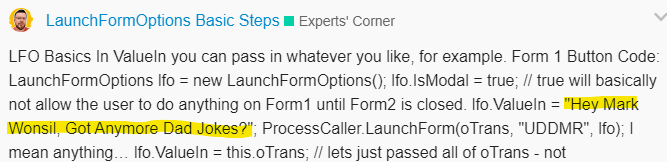

I don’t know if it will work, but ProcesCaller has an overload that takes launch form options.
Haha… I love that this was his example code:

Thanks, I will have a look at that link and see if there is something I can use. I did briefly try passing in a lfo, but not sure how to key into that from the Kinetic app. We will eventually be starting our Kinetic roll out, so I was hoping to use this as a test, but it may just be easier to just keep it all in Classic for now.
