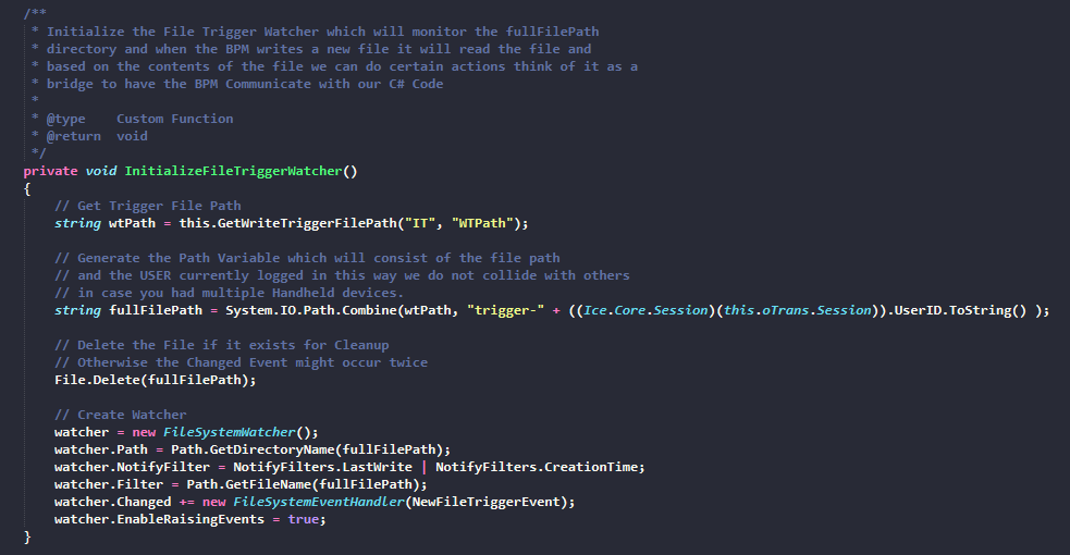

Aside:
I had a case where I had to call a custom Form on Packout based on a set of very complex BPMs in E9 - basically PCID before PCID came to Epicor Base, I used FileWatcher… Still works, but I am sure you can use some better polling stuff in E10.
The BPM did:
It was writing to EpicorData\custom\ and the Customization monitored that folder for “trigger-myusername”. Sounds like SignalR
