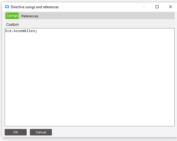

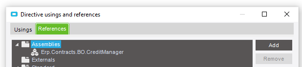

Firstly you need to get your using and references sorted. In this example I’m invoking a credit manager record set
