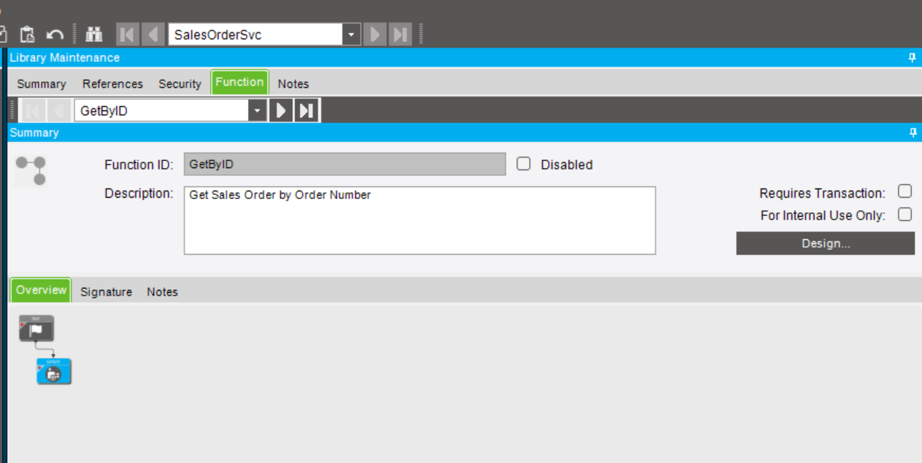

The function in CompanyA:

On the Security tab, make sure the other companies have access to call the function. I think by default it is limited to the company where it was first created.
Boy do I feel dumb. :woman_facepalming:
But I sure am glad it was an easy fix! :joy:
Thanks so much Andrew for your quick response!
Kelly
I’ve been bitten by this more than once, so I was familar with the problem :slight_smile:
