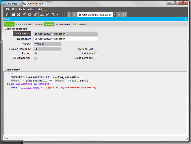

I want to know if it’s possible to call a BAQ from custom code that uses EpiBinding.
i know that creating a parameter for the BAQ could solve the problem, but i want to avoid having to maintain 2 BAQ that do the same thing.

// NOTE: In E10 field names use the format with an underscore. will no longer work.
bdvLeaveUsage.SubscribeToPublisher(yearPub.PublishName, "Calculated_PayRollYear");
//Oh yeah this thing takes another param (string) called a condition ... SQL condition that is... so pass in
//"=" or "like" or "begins" IE
bdvLeaveUsage.SubscribeToPublisher(typePub.PublishName, "LaborDtl_IndirectCode", "like");
