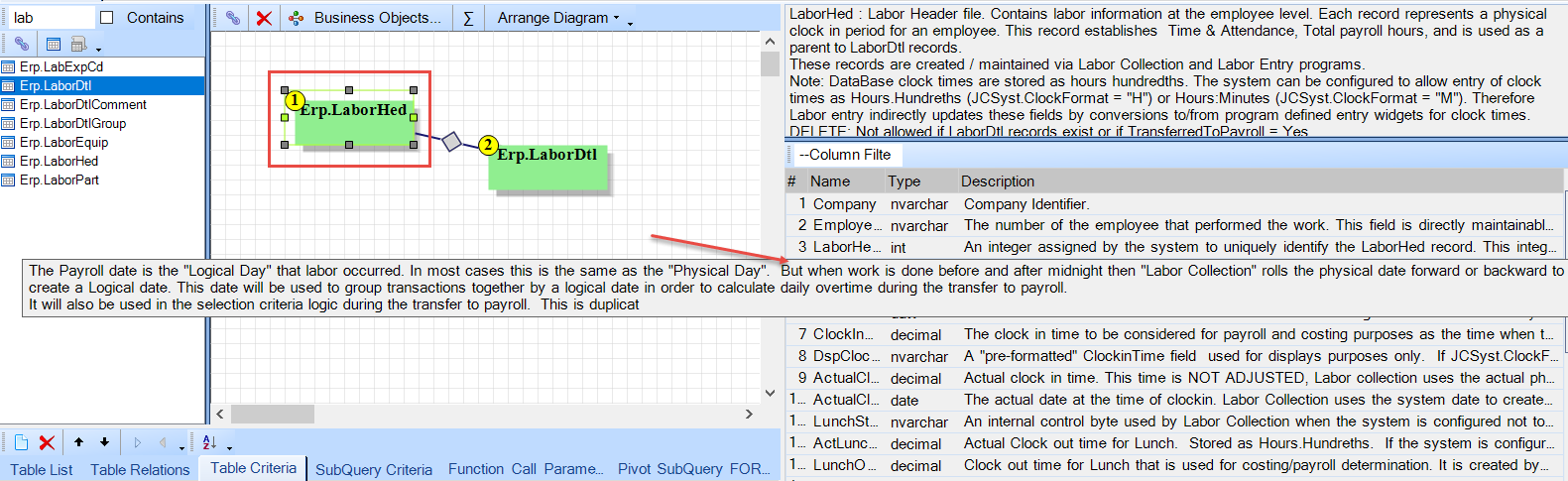

This often doesn’t work for people’s specific business needs, but Epicor’s way of handling this is the field PayrollDate. This date is intended to represent the date the labor entries count towards even if they were performed on a different date due to a shift spanning midnight. I believe it’s only at the LaborHed level, and it calculates based on which date the majority of their time took place. It can easily get jumbled if people don’t clock in and out when they come and go, or if they stay clocked in for days at a time.
Take a look and see if this might work for you.

I would agree with Craig that we normally use Labor.Dtl_Payroll date, but in your instance since you’re using real time recording the create date and time might work for you. I normally enter all the time manually the following day, so the create date and time would not work for me to query since it was not create in real time.
If it doesn’t workout for you then you could try Craig’s method and link laborHead to labor dtl file and get try to use the LaborHead.payroll date to see if that gives you what you want.
If the above formula doesnt work, try to do it using payroll date from the labor head table. it might be what you need based on the description of the field.
