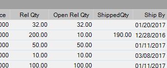

When I created a Calc field, there is not data in the field. I am linking Order Rel and Ship Dtl, so in the cases that we have not shipped anything, there is no data.
My calculated field: OrderRel.OurReqQty - ShipDtl.OurInventoryShipQty, so when 100 - NULL = blank. How can I get it so that 100 - NULL = 100

Perhaps I should of stated that I am trying to do this in a BAQ. I understand about the Total as well.
I get a syntax error using the case statement.

I was using the IsNull incorrectly. This worked.
if IsNull(ShipDtl.OurInventoryShipQty) then OrderRel.OurReqQty
else OrderRel.OurReqQty - ShipDtl.OurInventoryShipQty
