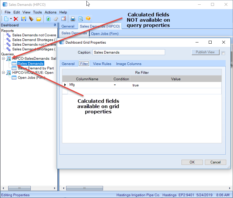

Although calculated fields aren’t available on the queries in dashboards you can set filters using calculated fields with grid properties.
Rather than using the tracker control you can add two grids, one that filters true and one that filters false…

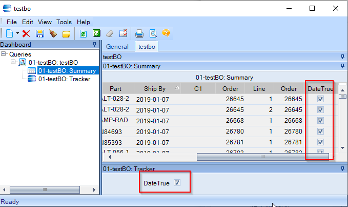

I don’t want a permanent filter, I want the user choose with a check box. Look the below image, the first one work because I’m in the dashboard editor. But in the second I’m in the deployed dashboard and the tracker filter won’t apply.
Thanks.
