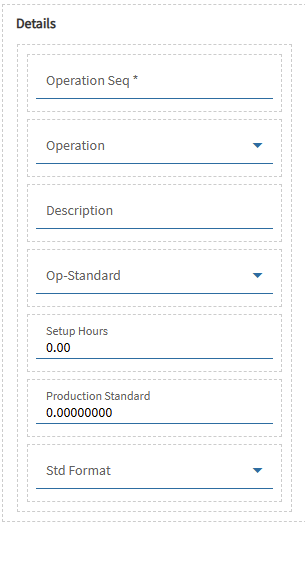

Our company uses excel files for quoting and estimates everything backward. When processing a job, we have to calculate the production standard and setup hours (see picture below). The excel file (estimate sheet) has the total cost of the setup and then a dollar value for parts/hours. We also have to look up each resource and see what the estimated setup and production rate is for the machine.
For every single operation, we calculate these values by:
Estimated Hours: Setup dollar value / estimated setup rate
Production Rate: estimated production rate / dollar value for parts/hour.
Is there a way to speed up this process? Is there a way to have 2 fields for the estimated setup cost and estimated parts/hour and then have epicor complete the calculations for us based on which resource was selected?
