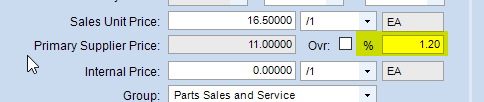

Can anyone help me do a simple calculation and display it on the part form?
Part.UnitPrice / Part.PrSupPrice_c = %
I could write to field Part.SalesPricePer or just display the calculation on the part form.
You can add a custom numeric editor to the screen and set it’s value in code.
Here’s an example setting myCalcNe to UnitPrice / InternalUnitPrice on the Part Initialize.
private void edvPart_EpiViewNotification(EpiDataView view, EpiNotifyArgs args)
if ((args.NotifyType == EpiTransaction.NotifyType.Initialize))
if ((args.Row > -1))
if ((decimal)view.dataView[args.Row]["InternalUnitPrice"] != 0)
myCalcNe.Value = (decimal)view.dataView[args.Row]["UnitPrice"] / (decimal)view.dataView[args.Row]["InternalUnitPrice"];
else
myCalcNe.Value = 0;
Thank you sir!
I added a second check for zero since i was getting divide by zero errors.
