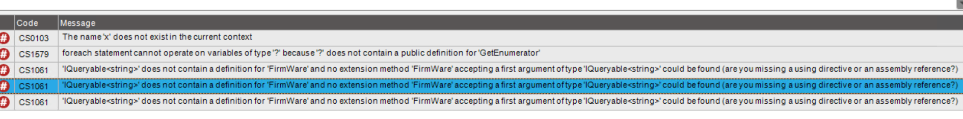

Thanks for the help :slight_smile: I am getting some Syntax errors.
The first one takes me to this line: x.BinNum == NewRecord.ShortChar02).Select(x=>x.PartNum,x.LotNum); and has the cursor on the x.LotNum
The second one takes me to the PartBinsTable in: foreach (var PartBinRow in PartBinsTable) {
And all the Firmware ones are in: if (LotTable.FirmWare != null){
decimal NewFirmware = decimal.Parse(LotTable.FirmWare)-NewRecord.Number01;
LotTable.FirmWare = NewFirmware.ToString();

@MelissaC I think @jwphillips solution will fix all of your errors. Since it isn’t recognizing your select method, the reference to PartBinsTable is giving you additional errors.

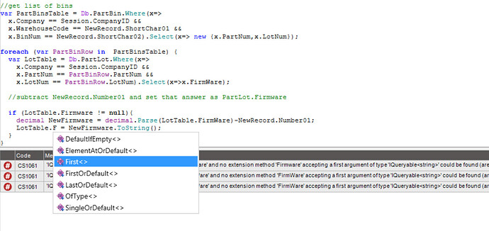

Adding new fixed the x error I was getting. I’m still getting an error on the LotTable.FirmWare. It looks like it doesn’t recognize it’s supposed to be a table? When I pull up the context menu (if that’s what it’s called) FirmWare isn’t an option. It only has function stuff, not table fields.
You selected a table. A table has rows. You have to pick a Row before you can get to a column.
In the PartBins, you are looping through each row. Then in the loop, you are selecting a LotTable, but you aren’t looping through that table. You either need to loop through it, or pick the first one or something.
This is because your LotTable is iterable. You would need to put a FirstOrDefault() after your select if you are certain there will only ever be one row returned. Right now LotTable is not a row but a row set.

Your LotTable variable will essentially be a list of FirmWare values, because this part of the phrase:
returns just the FirmWare value of each item that matches your criteria (whether none, or one, or all of them match) - so, as others have mentioned, add a FirstOrDefault() to the end of that statement. At that point, your LotTable with be set to a single FirmWare value (basically, LotTable = x.FirmWare, where x is the first PartLot that matches your criteria). You could forego the Select and just take the first PartLot that matches your criteria this way:
var LotTable = Db.PartLot.FirstOrDefault(x=>
    x.Company == Session.CompanyID &&
    x.PartNum == PartBinRow.PartNum &&
    x.LotNum == PartBinRow.LotNum);
Notice the use of FirstOrDefault instead of Where (you could still do .Where(criteria).FirstOrDefault() but it does the same thing)
And then check for null and do your work:
if (LotTable != null) {
  decimal NewFirmware = decimal.Parse(LotTable.FirmWare) - NewRecord.Number01;
Also, it looks like you’re attempting to update the value in the database. Once you Select anything from the database, you are working with the results of your query, and not the actual values in the database … so you can update them, but they will not save to the DB.
I have not been brave enough to directly update database values, so I have no experience to help with that part of your code.
