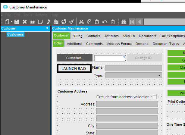

I was trying to make a Customization on the Customer.
I need to add one button (below the ‘Customer…’ one) that will display a new window with a custom BAQ (initiated with a parameter that would be the CustID selected).
111
Is this possible?
Thanks all!

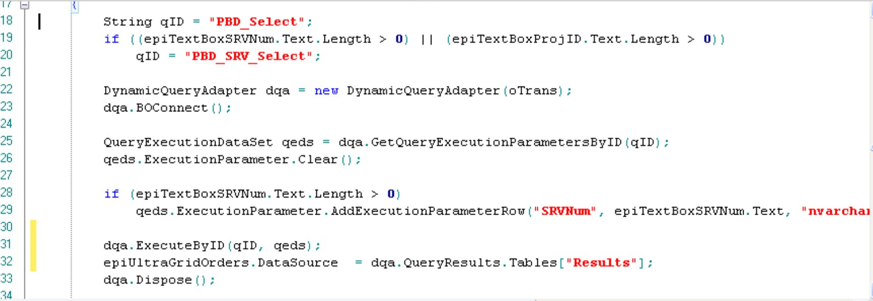

BAQ’s editing is generally only for the developer/power users, so you probably don’t want to launch the actual BAQ. What you probably want to do is make a dashboard and launch that instead.
Another option is to use BAQ zone depending on what you are trying to do.
If just displaying data from a BAQ, you could use the DynamicQueryAdapter in something similar to this:
