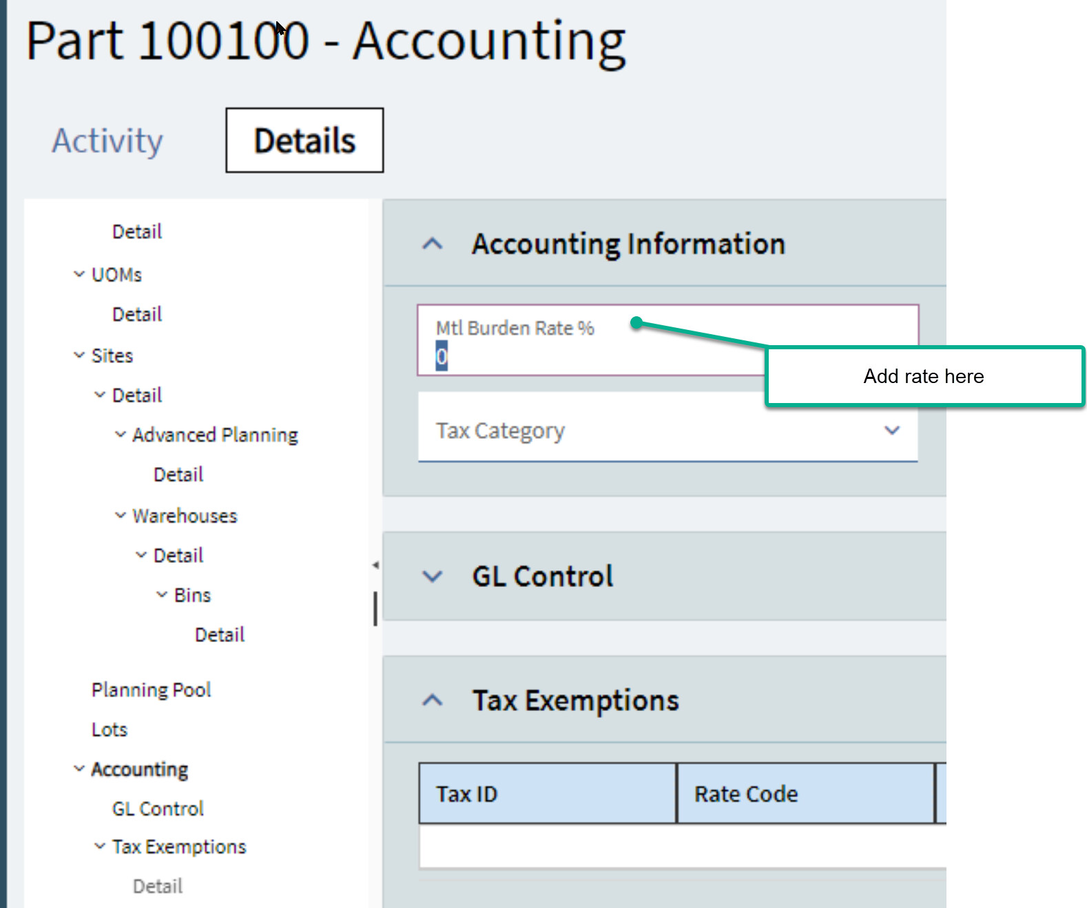

You can set the burden rate for the parts on the accounting card
on the classic form, the rate is near the bottom of the main form.

Thanks Bruce, in this case I’m not sure we would be able to use the Mtl Burden Rate %, as in my research it looked like this is incompatible with the landed cost module which we plan to implement in the near future. From what I had read you can’t have a Mtl Burden % on a part and also use the landed cost module for the same part, but I could be mistaken. Am I mistaken on that?
