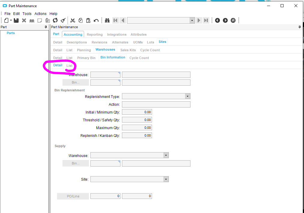

2- Make sure all values are valid and active. A few examples:
a) For instance make sure the From and To bin numbers are valid for the part. You can check if the bins are valid in this menu:
b) Make sure the UOM that you are using is valid for that part and bin
