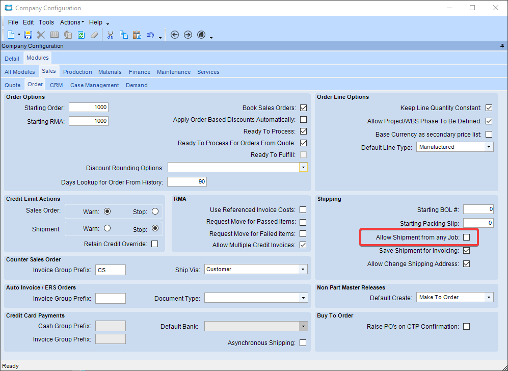

Does the Job have a Make To Order demand link to the Sales Order? If so, uncheck the Allow Shipment from any Job box in Company Configuration…
