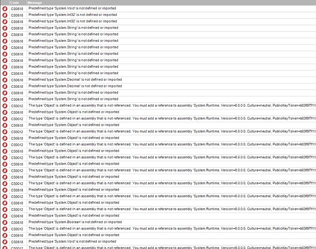

If I create a simple BPM with an Execute Custom Code with 1 line of code (int i=0;) I get an error - Predefined type System.Int32’ is not defined or imported

“I get an error - Predefined type System.Int32’ is not defined or imported”
That’s from as simple example as I could provide to recreate the error - one line of code for an integer declaration. Other “real” BPMs have lots of errors.

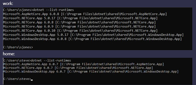

Here’s a screenshot from a non-working computer (work) vs my home computer that compiled the same BPM just fine:

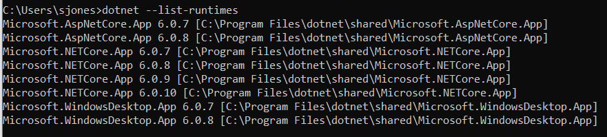

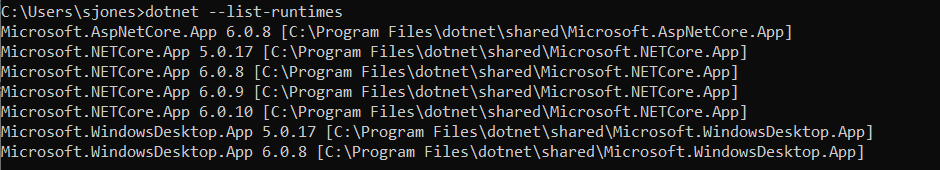

I have since uninstalled 5.0.17 and installed 6.0.7 - haven’t gotten it working yet. :frowning:
Scroll Down to 6.0.7 and install .NET Desktop Runtime 6.0.7 on your work computer
You may have to remove 6.0.8 and above

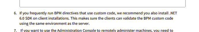

You need SDK to compile code. Runtime only lets you run it. When syntax check happens your client is actually compiling. The install guide specifically says SDK.
I’m telling you I don’t have it, and the sdk is not actually required to compile code. All the compilers are built into the runtime.
Install guide says 6.0.1 at time of writing but to install the latest version available so 6.0.8 shouldn’t matter.
Cool, but if he gets to the point of submitting a ticket, at the bare minimum he should have what the guide has asked @steve_j install .NET6.0 SDK on your client, restart, and try Epicor BPM custom code again. If that doesn’t work contact support for further direction.
