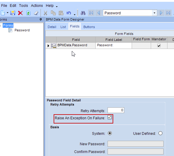

Am I missing the boat or did something drastically change in BPM Forms and the Password authentication functionality.
In E9 when you added the Password check functionality to a BPM Form, if the user typed in the wrong password you would get an actual Exception which would / could halt processing of the rest of the BPM.
In E10.1.XX when you setup the BPM DataForm to Prompt for a password as shown
The form will indeed prompt you and check the password
However after clicking OK… the rest of the BPM continues to execute with no way for you to check if the password was indeed valid…
Does anyone have any input here? Am I missing something? Shouldn’t the password validation cause an actual exception or at least return a validation status back to the BPM so that an action can be taken?
